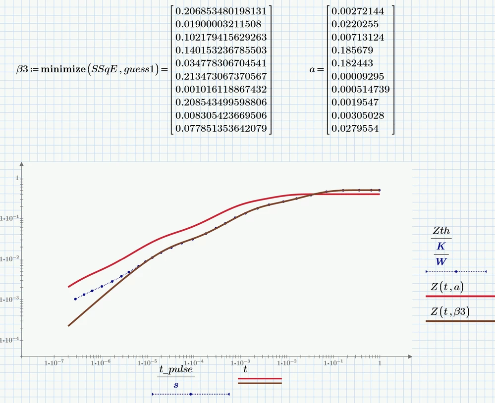

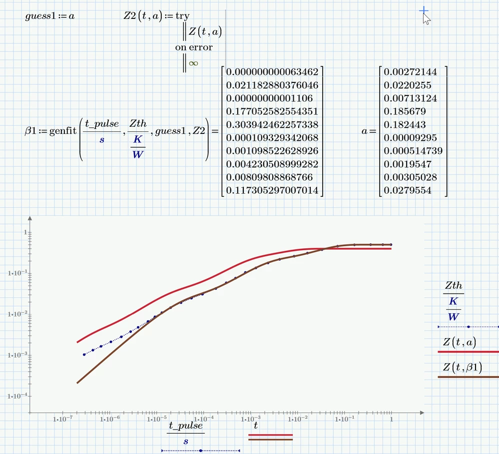

Why does genfit blow up when provided with the actual Foster Model thermal fitting function and guess values used within that model when fitting to @VD_12953418 digitized plot data?
I would have guessed that the genfit result would have been close to the plot of the model or to the example of digitized data.

You are absolutely right that Mathcad and Prime do not help in finding a suitable function type nor in providing suitable guesses. Thats what specialized programs like CurveExpert Pro are good in.
Your example is very sensible with respect to the guesses and so a guess vector with all 1's leads to an undesired result in Prime.
I tried using vector a as a guess (the values you wrote you want to improve), but this threw an error ("found a a number greater than 10^307"). So while jiggling the parameters around to find abetter overall fit, Prime ran into this numerical IEEE limit. This also shows that the function you try to fit is quite a the edge.
I wrapped the function Z in a try and catch and used this in genfit (omitting the partial derivatives which IMHO have no effect unless you evaluate it symbolically first).
Now a decent fit could be found:

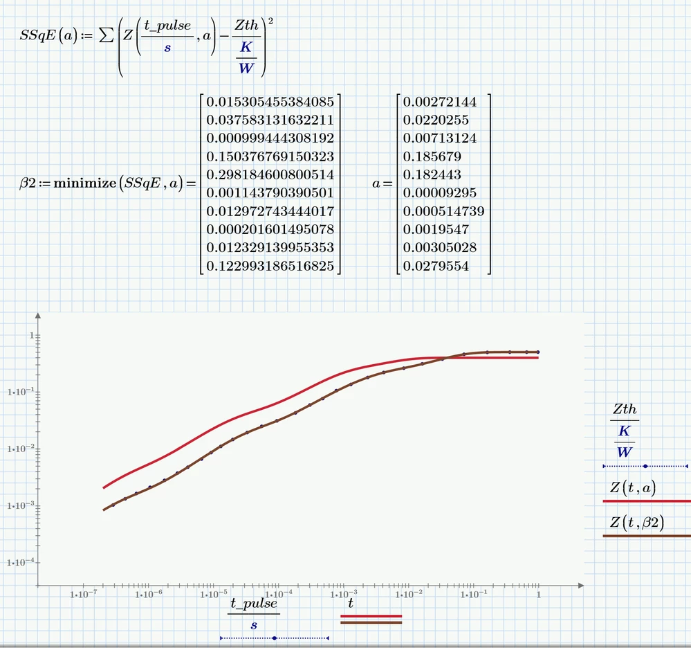

I also defined a sum of squared errors function and used "minimize" to find a good fit.
The result was even better!

"minimize" can be used stand alone but if you want to add additional constraints like a>0 you may also use it in a solve block.

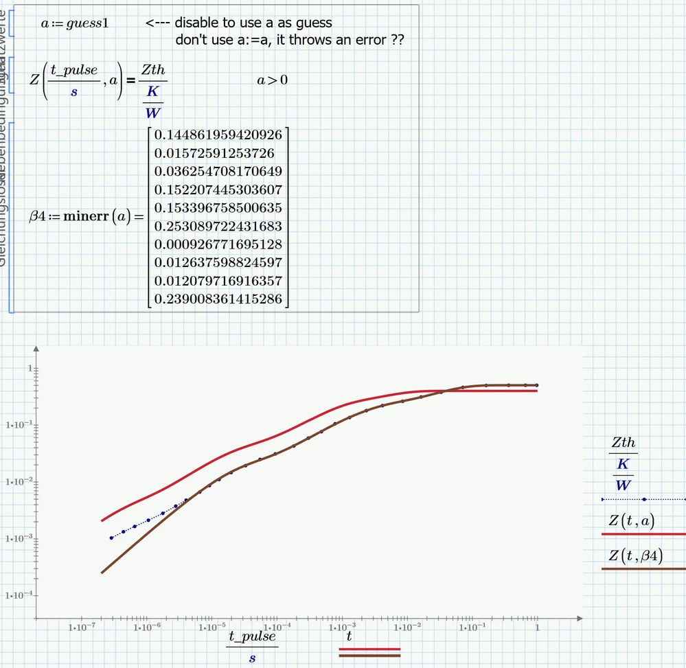

You may also use a solve block with "minerr".
Best result in this example was achieved by minimizing the user defined sum of squared errors function with good guesses (vector a).
