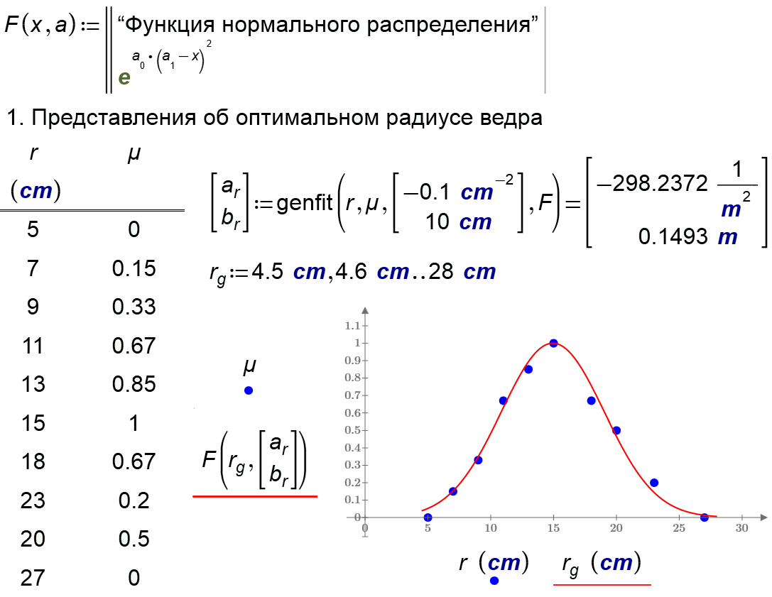

Dec 23, 2014 6:17 AM UTC
genfit works with units in Prime!
One example:
