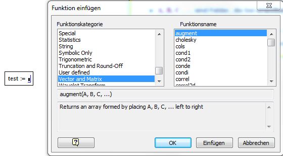

Now, thinking about it and discussing with the community, I have found a slightly better solution, although not perfect. "Funktion einfügen" (function insert) works in English if "mathematische Sprache" = English and it looks like this
with a little patience, knowing the function category, one can find "augment" or "stack" of my example, or any other function, remaining in the German-Help and German-User Interface.
