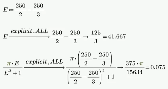

Mar 26, 2025 4:52 PM UTC
You could use the symbolic evaluation with "explicit,ALL"
Future versions of Prime may be able to hide the keywords and show the arrow as an equal sign as good old Mathcad could do (here Mathcad 15):
