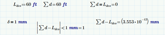

I hope everyone is going to have a great week ahead. I am having a problem with a if else statement. Although my summation is matching from both sides but it is evaluating as  "False" in output. It would be very nice if you can help me out with it.

I suspect the issue arises because, behind the scenes, Mathcad is working in meters.  So, working with feet engages a additional conversion calculation and that throws it's accuracy off.

You're running afoul of numeric precision; the summation is not exact, so the difference is trivially small but not zero.  Reformulate your test:

Like any other machine addition process, there is a small but finite error in each mathematical calculation.  You're sheet is doing twelve additions, so the error is multiplied by 12.  Then you asked if one number was exactly equal to another, and your computer (not Mathcad) looked at the two numbers and decided they wer not identical.
One of my early calculators would error if I took the sine (of the (sine of( the sine (of 1 degree))), then took the arcsine( of that number) three times; the last operation asked for the arcsine of a number larger than 1.  It was trapped by the error that crept into the process.
Research "numerical accuracy," it's been a dilemma for computer programmers since there were computers.
