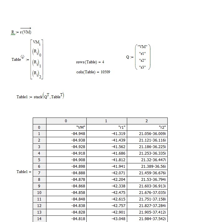

Hi all,
I am getting error as array dimensions do not match.
May be I used some wrong syntax for stack command
which I used it in the last line of my mathcad window.
Please someone help me.
I attached my code below.
Thanks.
23-Emerald V
I think it's because you've defined the header as a string rather than a 1x4 array ...
Stuart
-MFra-
Hallo VV,
23-Emerald V
Stuart
