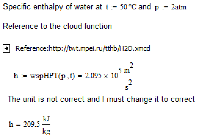

Mathcad internally works with SI units, no matter what unit system you choose to work with.
Ah, that's not true. Mathcad internally works with units of time (1T), length (1L), mass (1M), charge (1Q), temperature (1K), substance (1S), luminous intensity (1C) and money (1$).
They are by default defined as SI units (1T = 1 second, 1L = 1 metre, etc.), apart from 1$.
The only way you can control somewhat the behaviour of mathcad's working with units, is by telling it to not use any unit system. Then you can, no, have to, define your own unit system. The downside of this is that you have to tell mathcad with most every result what the unit is you want it to be displayed in. Basically that is the same as what you can do now: without defining your own unit system, but using a built-in one, just fill the units-placeholder of a result with the unit you want in there.
In short: you've searched and not found for good reasons: there is no way of forcing mathcad into using the units of your choice in its results other than to set those units (every time...).
March 12, 2017
I am a thermal engineer and use cloud
functions with properties of working fluids.
One example:
