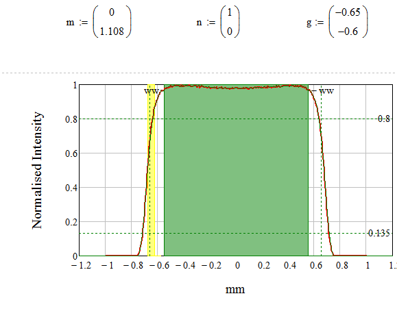

Hi, please see the attached. Im trying to find multiple x values of my plot for various y values using Given and Find. I'm not sure how to set it up to give me a vector of y values for a vector of x value inputs.
Also, is it possible to draw the rectangle on the graph as per my second request.

You can create a function from the solve block:
and feed it multiple values (note that "vectorization" was required:
As for your second request, change g:

Jbryant611-VisitorAuthor
perfect, thankyou
