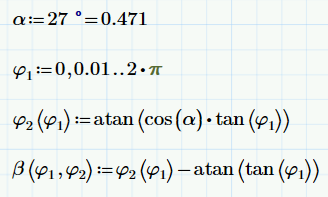

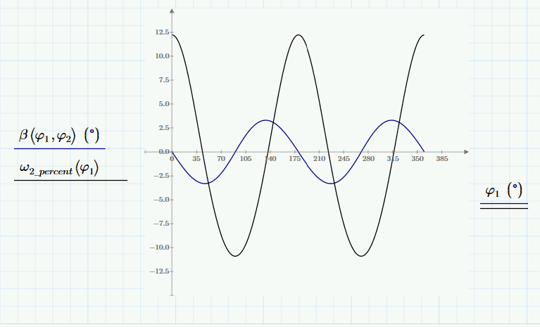

I am plotting the angular difference between the input and output shaft (beta) of a universal joint at an angle (alpha).
How can I get the maximum value of the function beta? (where beta is a function of phi1 and phi2, and phi2 a function of phi1)
I am using Mathcad prime 3.0.
Best regards
Christer Vestermark
The relevant equations:
The plot, where the relevant function beta is purple.

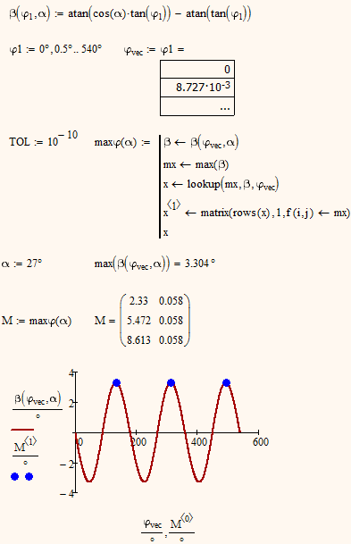

How to do it with function was shown by Dmitri. You need a guess and you get just one value.
Another option would be to turn beta into a vector and use the built-in max() function.
Maybe the attached picture helps. I am using a dirty undocumented trick to turn a range (phi) into a vector (phi.vec)

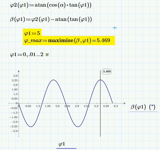

Hi, Christer,
in your case you can use beta as a function of single var phi1 instead of two vars.
Note that result depends on the guess value of phi1 (try 1 instead of 5).
