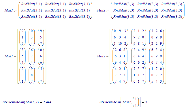

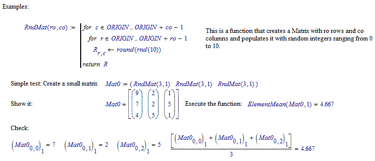

February 1, 2017
Here are a few possibilities:

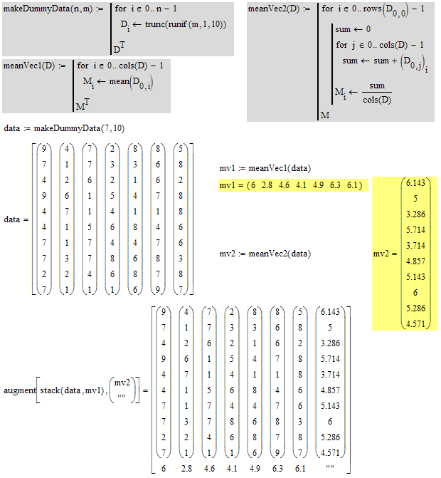

I have a 1x7 matrix of 10x1 matrices. (below)
I'd like the mean of say, the 5th element (cue Mila Jovovich ) of the 10-element matrices.

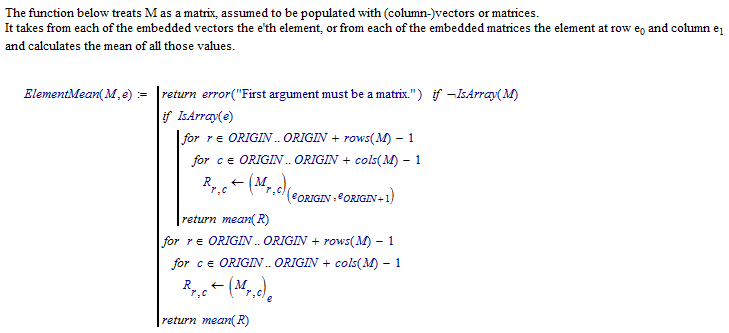

February 2, 2017
This should do what you want, and possibly more:
February 3, 2017
Here are some ways to calculate the one or the other mean value:
