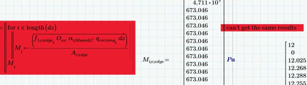

You forgot to attach the excel data file. The one you posted earlier does not have a sheet #28.
Maybe you are looking for
as I don't think that you expect a nested vector of vectors, which you would get if you omit the index i on dz. Vectorization isn't necessary anyway.

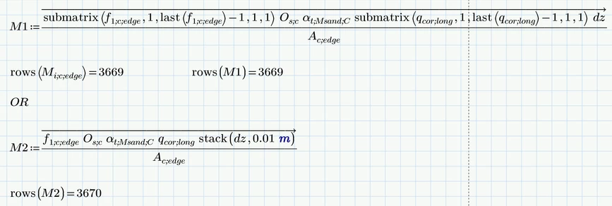

EDIT: An easier way to achieve the same result would be
but it fails because vector dz has one element less than the other two vectors involved.
So you would have to make all three involved vectors equal in length, either by getting rid of the last elements in f.1... and q.cor... using submatrix (this gives the very same result as the program shown) or add an additional 0,01m at the end of dz (which results in in a vector M2 one element larger).

Hello, Yusra.
Could you please upload your latest version of "CPT input gef.xlsx"?  The version I've got creates errors when it tries to read range "[28]A2:D2196".
However, looking at your program, I'm wondering why you return Mi instead of M?
