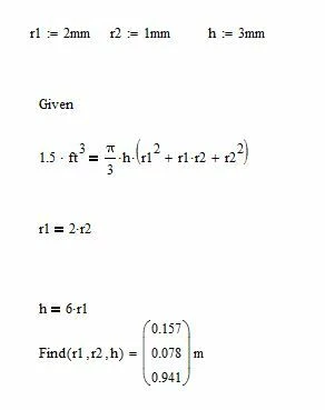

There are two changes needed.
(1) Put an explicit multiplication between h and the bracketed term.
(2) Change your initial guesses so they are not all the same.
Alan

Hi Alan
Thanks that is sorted, I didn't know the initial guesses couldn't be same!

Sometimes they can!  Just not in this case!
Alan
