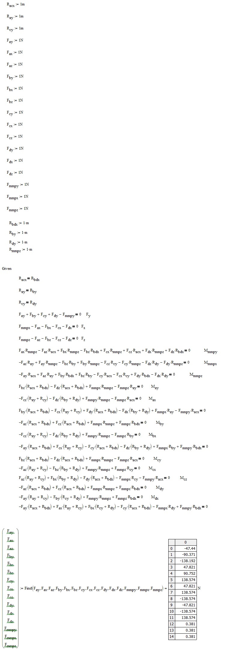

I'm having a problem with MathCAD 15 to calculate forces.
I need 15 variabels (Fay Fax Faz, Fby Fbx Fbz, Fcy Fcx Fcz, Fdy Fdx Fdz, Fmmpy Fmmpx Fmmpz) and had 21 formulas. I red somewhere that it had to be 15 formulaes for 15 variables.
So i managed to get rid of 6 formulas.
Still undefined when i try to use the "find" function.
Hope someone can help.
Jeroen

when using the error tracing tool (Right-click on solution and choose "Trace Error") it says that your variable Rbdx (among others) is not defined. These need to be defined as starting values.
Good luck
Raiko
January 6, 2017
Hi Jeroen
are missing some initial guesses

Still having a lot of problems with the answers.
For now, I Need:
F.mmpy = 190,2558 [N]
F.mmpx = 0 [N]
F.mmpz = 0 [N]
F.ay=F.by=F.cy=F.dy=F.mmpy/4
R.acx=R.bdx=0.05029 [m]
R.ay=R.by=0.378501 [m]
R.cy=R.dy=0.205599 [m]
Can't share my current file in this text..
January 12, 2017
Hi Jeroen,
You can get what you want by entering in the Solve Block the conditions to be satisfied by the system.
To have a solution you have to change the initial estimates until you get a solution (which is not easy).
I added after the Solve Block the same equation for verification. See Attachment.

I've started all over again because I couldn't get it working correctly.
I hope someone can help me because my deadline is friday...
Regards
January 18, 2017
1. You have 12 equations and 8 unknowns!
2. Your system is linear. Use please the lsolve function! See please Given/Find and lsolve for one problem here 17.15 and 17.16 here Study 17. Cogeneration (CHP), trigeneration (CCHP) and quadrogeneration (CCHPI) or how much of mathematic is contain…
