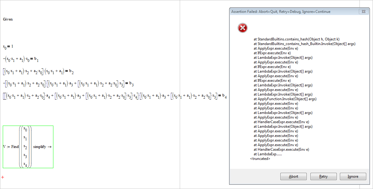

Given_Find( ) solve block & Series Equation.
The Question : Need help with Given_Find( ) solve block solution.
Thanks in advance for the time and help.
Regards.

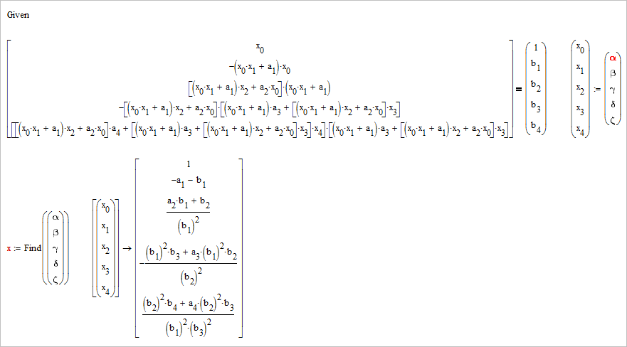

You have the same solution. You basically solved the system by re-defining the unknown x vector variable using literal (individual distinct) variables.
There is nothing wrong... but you cannot avoid the use of literal subscripts if you really want to use the Given/Find block. See also attached.
41 replies
July 27, 2013
The solution
and the file with a small change. Hope that is what you are looking for.

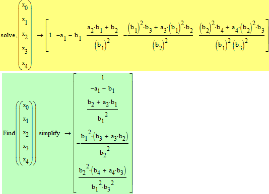

July 27, 2013
Preferrably you can use the symbolic "solve" as Mihai suggested.
If you want to use the solve block you should use literal subs.

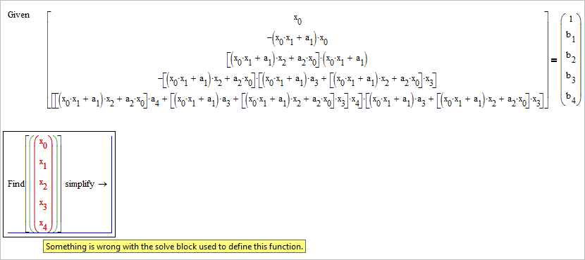

I have Mathcad14, Werner. And it shows up like the following :
Regards.
July 27, 2013
I use MC15, but my file should work in MC14 as well, unless there is a bug which was fixed in the meantime.
Which maintainance release of MC14 are you using?
Did you change anything in the file other than the assignment V:=

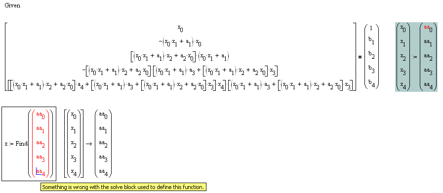

Hello again,
Many thanks for the two of response, above.
The question : I think of mine, above, there is something wrong and mine is not reliable (solution) ?
Regards.
July 27, 2013
