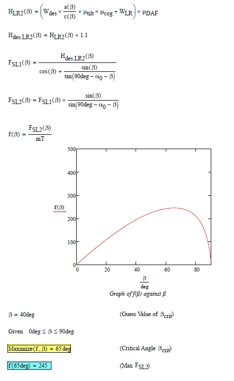

hey lads, its me once again. I asked a question regarding the angle beta and it was solved by the awesome individuals from this community. But now I have another problem because of this. I need to global assign this beta value so that my calculations can be automated instead of me manually typing beta every single time! helppp!!!

You can assign the result of a solve block to a variable name.  (See purple in attached.

Sorry for the late reply guys. I forgot to tell you that all my values about have been globally assigned as I needed to put some values for a summary at the front of the mathcad sheet. Thats the reason why I kinda of have difficulty assigning the result of a solve block to a variable name. I cannot globally assign the result to a variable name.
May 24, 2016
I have had the same issue. My conclusion has been that it is not achievable.
What I do is I create a separate summary worksheet. Then I create a collapable area at the beginning with a reference to the original sheet. Then all results are available for writing a summary. Then I print both documents to pdf and merge them. It is not a really pretty solution so I hope that someone has a better suggestion.
