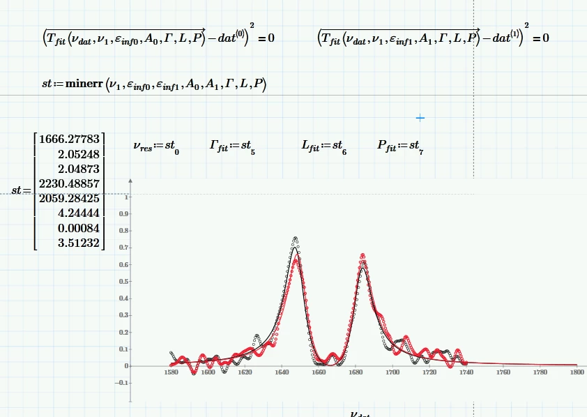

Here is an approach without your sse function using minerr and letting Prime do the sse minimization that way. Its better with this approach to set the vectors to 0 and not the sum of its elements.
Are the results more suitable?
bsimpkins1-VisitorAuthor
thanks.  the "minerr" approach is better.  it gives results that are not locked to original guesses (and is much faster!).  however, the results are quite sensitive to initial guesses.   i'll dig into a different data set.
