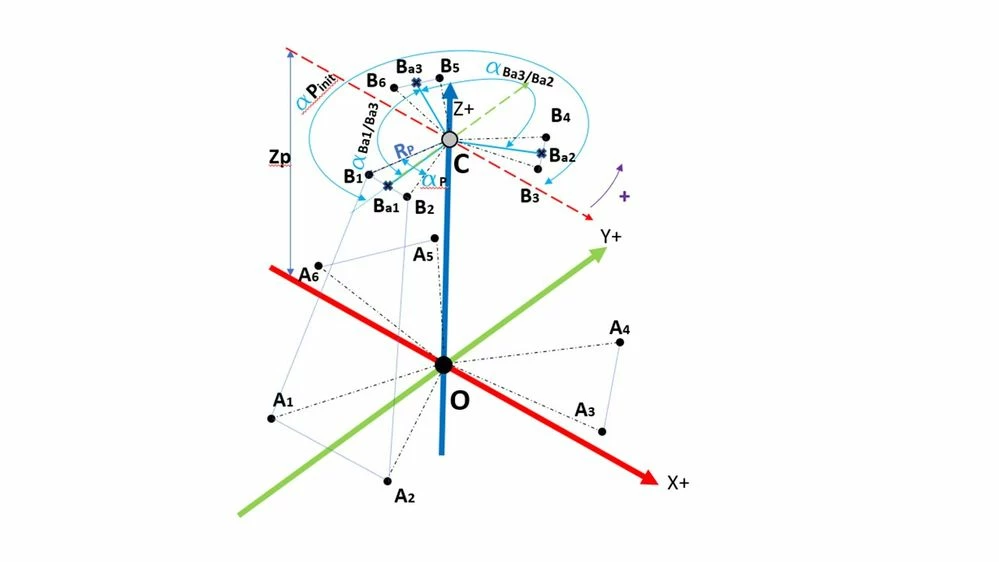

I want to use a hexapod (gough stewart platform)  in mechanical application.
The hexapode is formed with:
_ 1 base plate (ground)
_ 1 end effector (platform)
_ 6 leg (mechanical drive effector)
This system have 6 DoF for platform
For build this mechanical device, I need to calculate:
_ inverse kinematics : If i know the posture of platform, I find the leg lenght
  (the posture is : 3 positions : dX,dY,dZ and 3 rotations : dRX,dRY,dRZ)
_ Leg Forces (traction-compression only generated in leg)
For start, i build the geometrical model, for this, i define a ground mark : O with coordinates 0,0,0
1)
I define the hinge point of base : Ai
2)
I define the hinge point of platform : Bi
3)
I define the C point is the géometrical center of platform
Now the leg are AiBi vector
I define a user mark
The  user mark M ( 3 positions + 3 orientations) is define to mark O ( the origin of mark M is the point of interest)
For moving the platform, i define a new mark Mc from M
This mark is mark M augmented with strokes
And finally i calculate the AiBi vector, and i find the leg lenght.
I calculate AiBi at nominal position : not mouved platform
I calculate AiBi at mouved position
I find the stroke of effector (leg displacement)

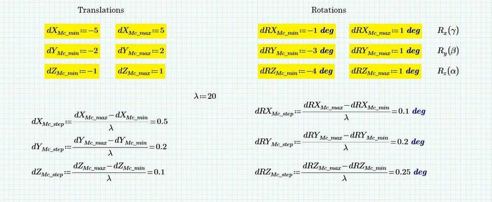

Now I have a problem for Trajectory calculation
For know the stroke of effector, is necessary to compute leg lenght for trajectory.
The start point is define with stroke (in Mc)
dXmin  dRXmin
dYmin  dRYmin
dZmin dRZmin
The end point is
dXmax  dRXmax
dYmax  dRYmax
dZmax dRZmax
I use a lambda parameter for hash trajectory with 20 points for example
Now I find 20 group of position parameter.
I want to run my calculus for all position  group, and finally i make a graph with leg lenght for position parameter group.
My calculus is right for calculate leg lenght for one position of platforme in 3D space.
But i can’t calculate for trajectory ( group of parameter ) and i can’t make a graph
I’am a mechanical men, not a software programmer (lol)
Do you can to help me ?

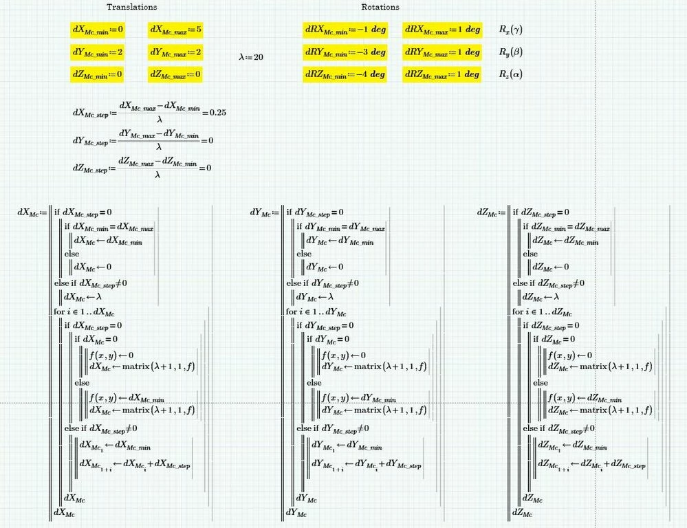

XDN14-AlexandriteAuthor
and trajectory worksheet
in first step. Perhaps i make 2 program Smiley Frustrated
first:
Calculate all coordinates for trajectory points in 3D space

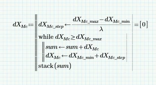

now
i make program wich calculate sucessive positions for all 6 parameters
example for only dX translation:
first position is  dXmin
second position is dXmin+dXstep
...  ( the step is (dXmax - dXmin) / lambda)
end with last position = dXmax
All position (dX,dY,dZ,dRX,dRY,dRZ) are must be concatenated in matrix Mc
Perhaps :program.JPG
Smiley Mad wrong ! it's don't work Smiley Sad
I am bad in programming  Smiley Sad
please help me
I don't understand to correctly use mathcad program Smiley Frustrated

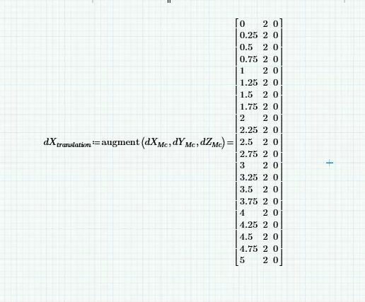

 in this example
dX move 0 to 5
dY don't move, but the steady position is 2
dZ d'on't move
i think its OK, but is not elegant Smiley Wink
