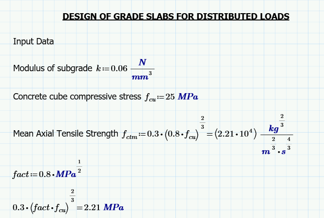

Attached is an mcdx file. I have an issue with the units. I'm expecting the units for fctm to be in MPa. But Mathcad does not seem to be in agreement. If I remove the 2/3 from the equation then the units are OK. Kindly help.

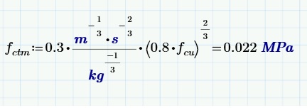

The coefficient 0.3 is dimensionless? otherwise:

Anyway. You raise an expression (0.8 * fcu) to the power 2/3 where fcu has units MPa, and 0.8 has no unit.
Then you MUST expect the unit of the result to be MPa to the power 2/3.
Is it certain that 0.8 has no unit? If it had the unit of SquareRoot(MPa) then you would get MPa as a result.

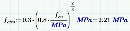

April 4, 2017
Here is another way to deal with an older unit-less formula where you are told "enter the compressive strength in MPa and you get the tensile strength in MPa".
You strip the units of the input values by dividing through the proper given unit and add the correct result unit at the end.
Not the way one should work in Mathcad, though, but its often not that easy to make a formula unit-aware..

Many thanks for the response. I didn't know if I could attach files in a discussion. Anyway next time Ill start a discussion instead. Anyway, in my equation both 0.8 and 0.3 are constants with no units. Looks like I don't have any other choice than the work around suggested by you.

If the expression you are using is derived emprirically, then rather than to attach a unit to 0.8, I think it's better to remove the unit from fcu inside the power and afterwards re-attach it to the result, as Werner has shown.
