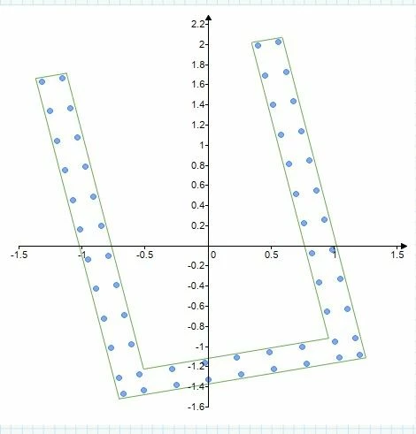

Dear community friends, I have a problem generating an automatic graph from the data of a matrix as shown in the spreadsheet. Mathcad Prime V.8.0.0
Translated by the Community Moderation using Google Translate
Estimados amigos de la comunidad, tengo una problema al generar un gráfico automático a partir de los datos de una matriz tal como se muestra en la hoja de calculo. Mathcad Prime V.8.0.0

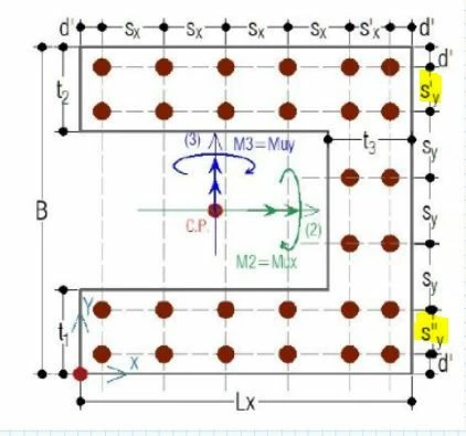

Tried the file with t1, t2, t3 set to 45cm in turn and found it does not plot OK.
Swap the definitions of S'y and S''y
That is S'y is associated with t1 and S''y is associated with t2
The enclosed versiom [v2] of the file is then OK

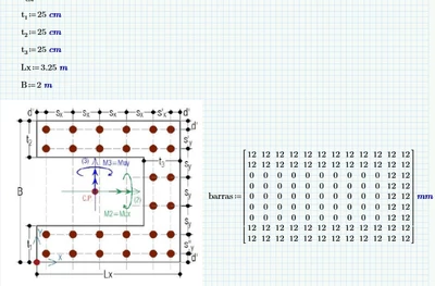

Version 8.0.0.0 file below.
Calculates the elastic centre of transformed section and aligns with neutral axis.
Should have more wording to explain what has been done
