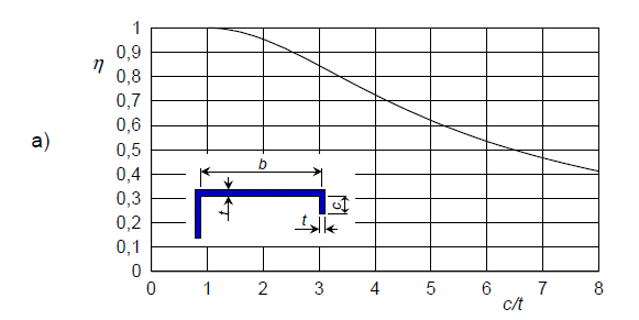

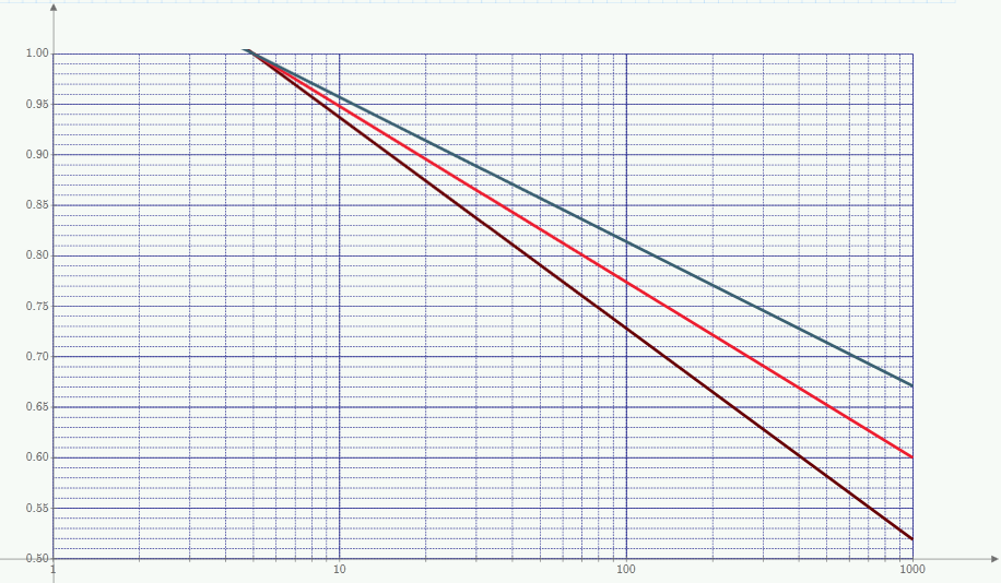

Hi.   How can I make the graph in Mathcad prime similar to this figure. Do I have a missing formula ?
Werner_EAnswer
December 17, 2015
Lex Dante wrote:
I have here a graph where grid line are not symmetrical. Are this possible to create  using Mathcad prime  ?
Yes, its possible!
Regards
Werner

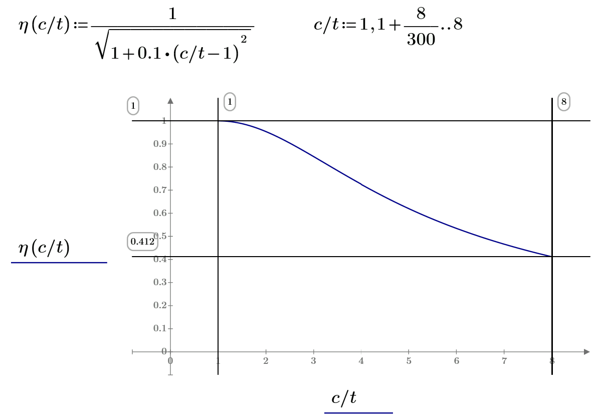

See please the picture and Mathcad Prime 3 sheet in attach!
Do you need grid?

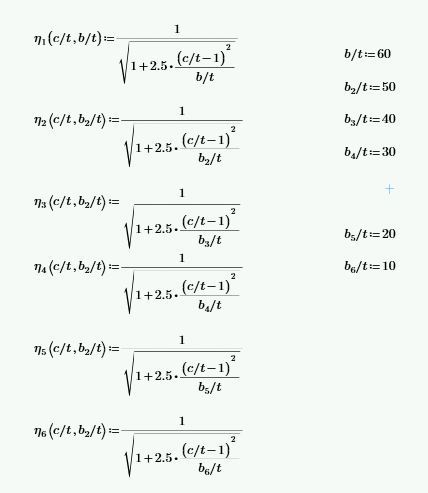

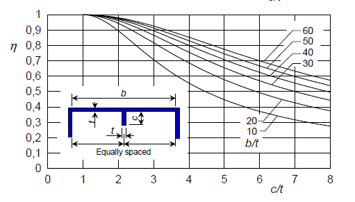

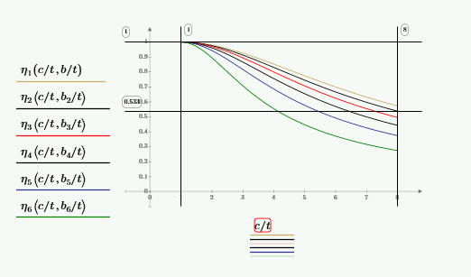

I appreciated your help . Can you please help me bout this one also
ldante11-GarnetAuthor
11-Garnet
November 26, 2015
Is this correct . is there any simplified method of this case ?

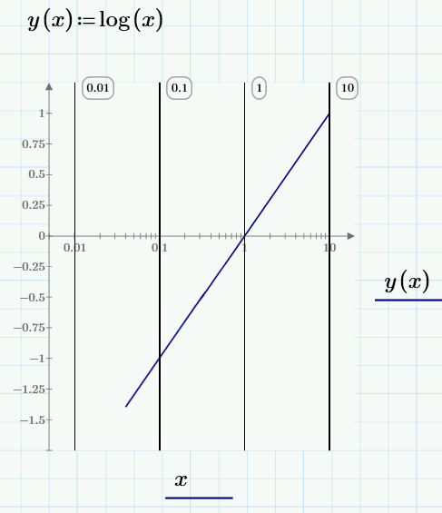

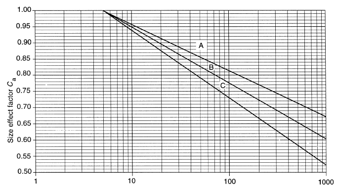

December 17, 2015
Log scale is in Mathcad Prime, but no grid
Or

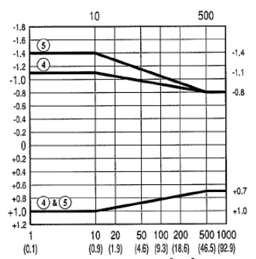

I have another graph where the vertical axis started from negative (-1.8) down to (+1.2) . is this also needs a special command to reverse the vertical graph as shown in the picture?
December 20, 2015
Lex Dante wrote:
Good day ..
Unfortunately Prime is very limited when it comes to plotting. Unlike in Mathcad 15 (and below) we cannot reverse the axis in Prime. There is no special command or option available to do so.
