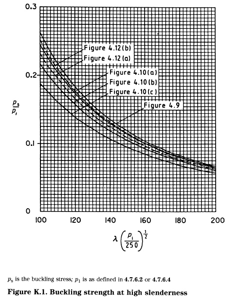

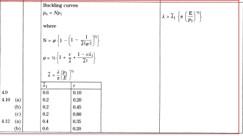

I cannot make the graph similar to this. Please help me.

First error: For some reasons you define a vector lamda1 and later you want to redefine it with an expression using unknown variables lamda and p1. You have to be aware that Prime reads your regions from top down and from left to right. So if you use a variable it has to be defined above or at least to the left (unless its the independent argument of a function you define).
Concerning the rest it sems that its unclear to both of us what you are trying to calculate and graph.
