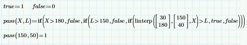

Graph pass and pass criteria
Hi all i want to interpret a pass/fail criteria based on if the point of intersection is above or below the  x-y axis line
i.e. for example this would be classed as a pass where the lines intersect below the loading envelop
thanks
Ben

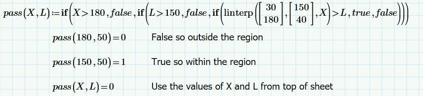

terryhendicott
The formula does work.   Enclosed is a revised sheet.  After the definition of the function "pass(X,L)" it can then be used.
180,50 gets a zero or false for outside the region,
150,50 gets a 1 as it is within the region.
then use X,L from the top of the worksheet in the pass function.
Cheers
Terry
terryhendicott
HI
Enclosed statement does the trick.
Cheers
Tery
Thanks Terry
that equation hasn't worked as shown below, if i make X=180 if is outside the loading envelope and therefore should be a fail (i.e. a pass in the underside of the line).
terryhendicott
Cheers
Terry
