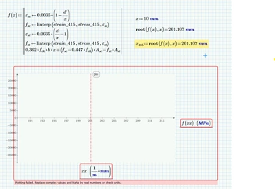

While plotting a graph, I receive an error.
Please assist me in fixing the issue.
Please find the attached document below.

Variable xx is undefined.
Primes quickplot feature can't be used with units.
xx must be defined as a range with units:

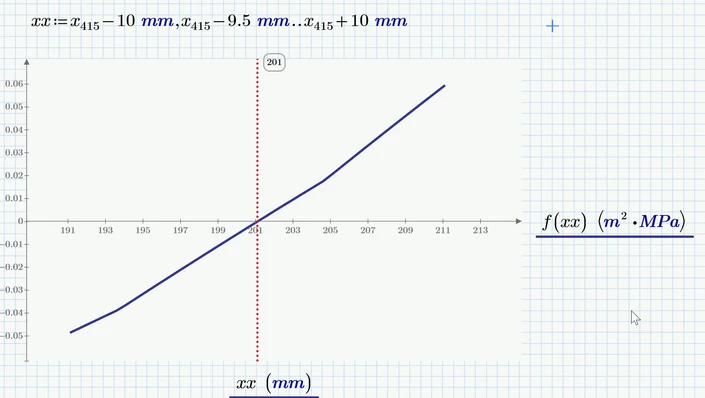

Werner_E25-Diamond IAnswer

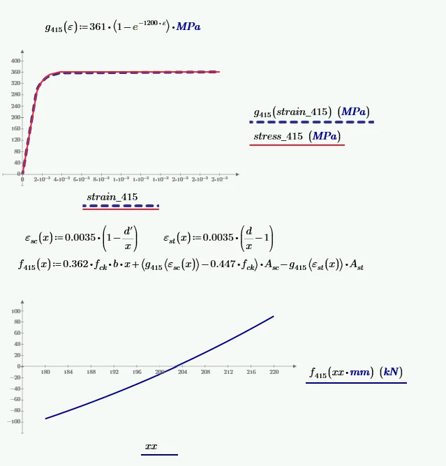

By plotting your stress-strain curves, I could see that they closely followed an exponential type, so I roughly fitted them (by eye).
You only need to define your "f" functions once - see attached.
