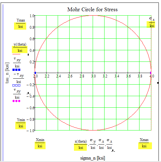

The values you see semm to be in SU unit Pascal. Even though you have chose U.S. system this seems to be the unit system chosen by the plot region if not otherwise told. Generally the values in a plot should better be unitless, so divide ALL by the unit you want, not just a few.

Thank you Werner!
where do i change the unit for the plot if i want to?i never knew the plot has a seperate unit.

I am not sure but I guess thats hard coded. Just make sure that all axis arguments are unitless by dividing them by the desired display unit. So get back control.
