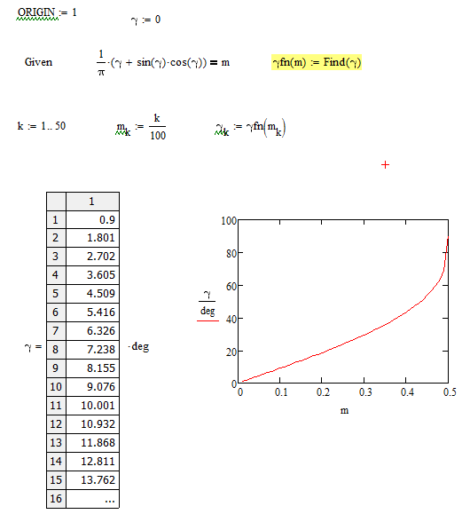

But we can post a picture.  Perhaps the following is what is wanted:
Alan

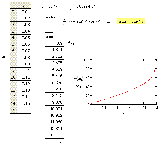

...Or with vectorization.
Viktor
