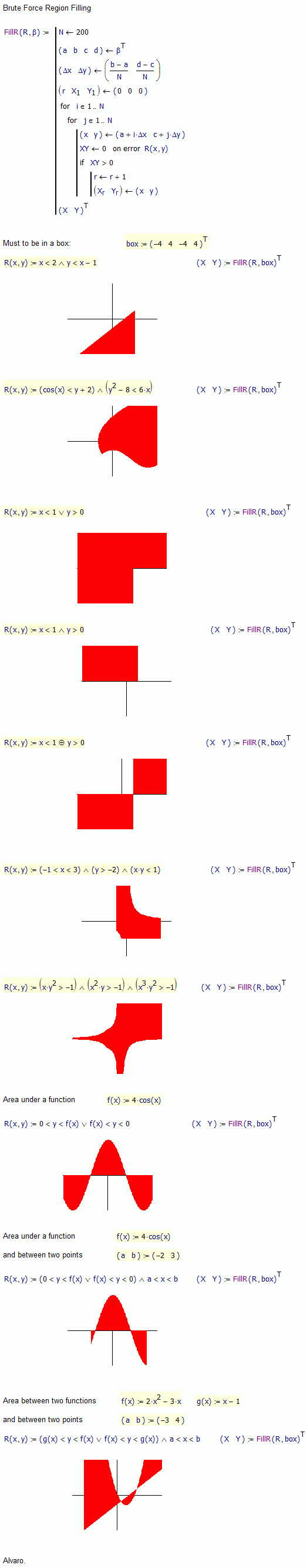

graphing inequalities in mathcad and shading an are of interest
Is it possible graphing inequalities in mathcad and shading an area of interest in the graph?
Example
graph these inequalities and shade the are that found at the interception points
y<=3-(x/4)
y<=6-x
y>=1
x>=2
thank you!
juan.

You can bound and "shade" in version 15 (with a little imagination).
Might be able to get creative in Prime; bounding is the same, shading would be a larger challenge.

Simple brute force surface filling. Can be improved a lot, but is very effective. Topology is hard, so, following examples have not holes. Also, can extract the border (asking for abs(XY) < TOL or something else better). This is some sort of equivalent of differentiate functions. The notations is similar to: dR = Border(R). Well, partial d, can't found greeks here. ORIGIN =1.
Best regards.
PD: Can't type this in Prime, sorry.
