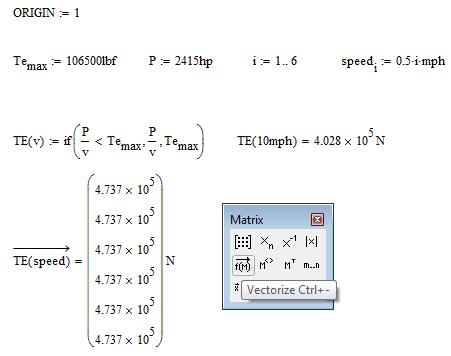

You have to use vecorization when you call TE(speed). EDIT: As Valery just showed while I was typing 😉
The vectorize operator is on the matrix palette. You should get TE(vectorize) with an arrow over it.
That way every single value is fed in your function and the results are collected in a vector.
The way you did it you fed TE with a vector, So in your function TE the argument v is a vector, and so P/v is a vector, too (Mathcad uses automatic vectorization here). You can't compare a vector with a constant TEmax and so you get the error.

Thanks Werner and Valery!  It was the implicit / automatic vectorization in some cases that caught me out - it worked for other cases (such as aerodynamic drag) but not this one.
From Valery's screenshot I've noticed the alternative approach, to vectorize the result using my range variable i as a subscript - I can see that both methods work, both for displaying a result vector and for defining the graph.

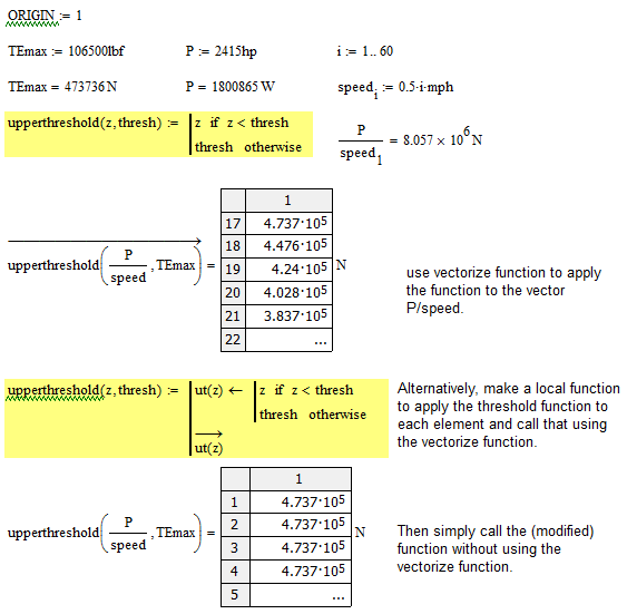

An alternative approach is to generalize the upper threshold function (if you feel you might use it again), and use a local function inside it to deal with the vectorization.  You can just use it with a vector or scalar as you see fit.
Stuart
March 2, 2016
Thanks Stuart - I'm going to have to think about that some more...
