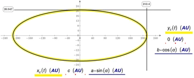

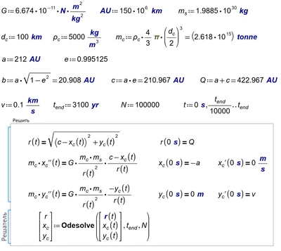

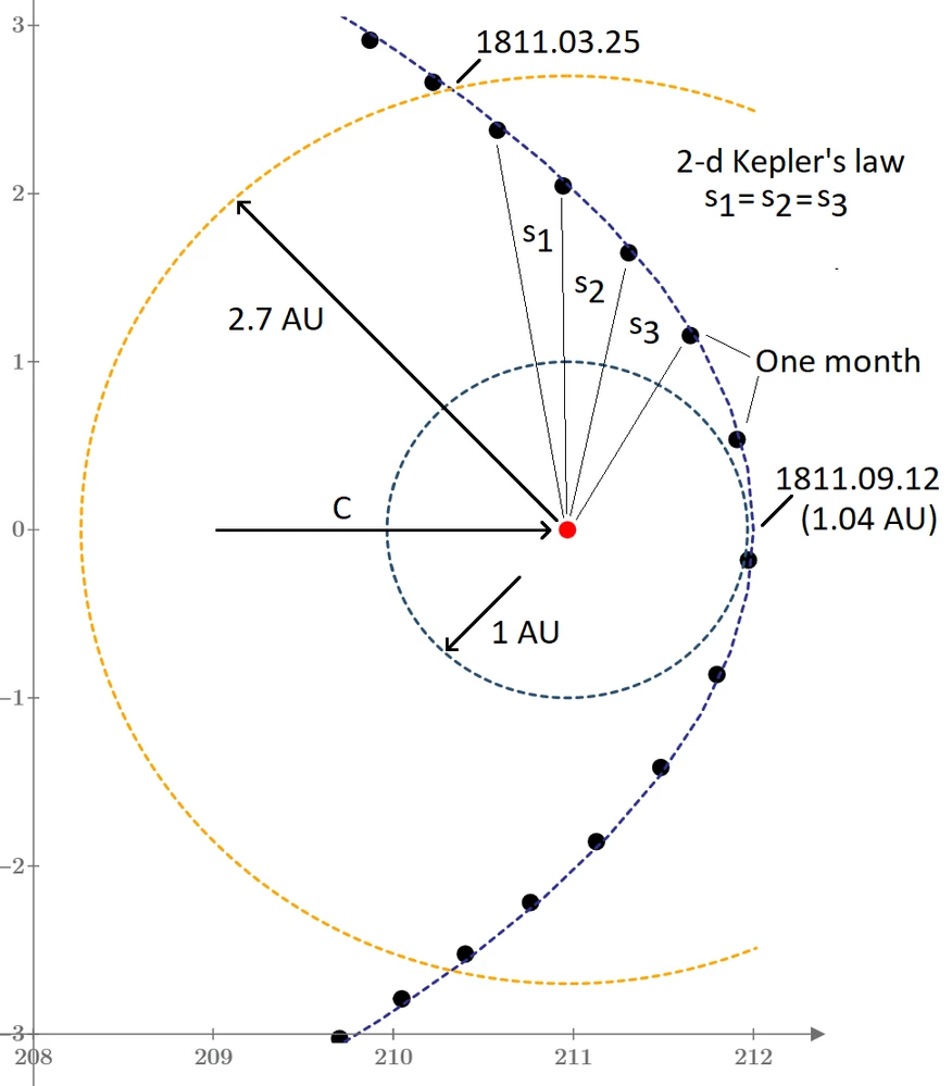

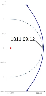

More interesting picture and Prime 6 sheet. Can you point Earth here?

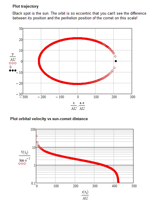

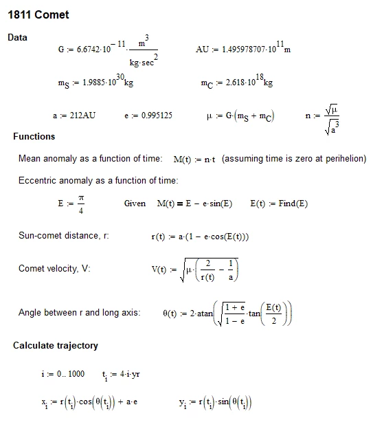

Here's a different way of looking at this (ODE's already solved analytically, as it's a two-body problem).

Thanks, Alan.
But the numerical solution more simple for the undestending.
