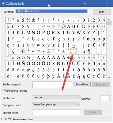

I understand your question to mean that you want to use Greek letters in a string variable.
Unfortunately, the editing options in a string are indeed very limited. For example, you can't select individual characters to copy or delete them, and, as you noticed, the shortcut Ctrl+G doesn't work either.

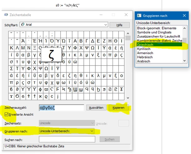

You can still use Greek letters, however, by copying and pasting them into the string. You have at least three options:
1) Start the Windows program "Character Map" and copy the characters from there.
2) Create a math region (a variable name) in Mathcad using greek characters and copy from there
3) Create a text region in Mathcad using greek characters and copy from there

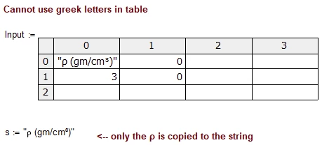

Thanks, butt I cannot see how to use it in a table.
Jun 30, 2025 8:49 PM UTC
You cannot copy a math regions which contains math operators like division or exponentiation. just copy the rho to a string and type the rest
