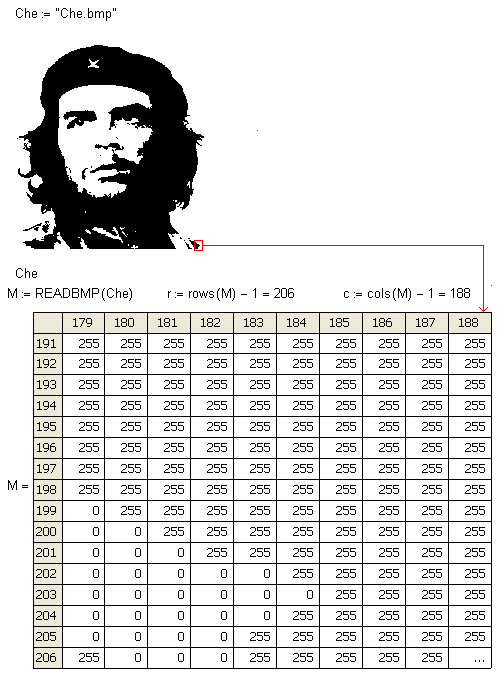

May be this picture help you:

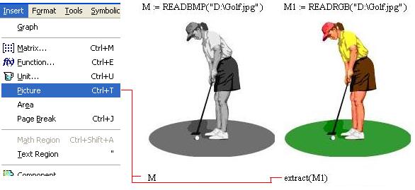

Bill, see also this :

Thank you for the reply but this is the inverse of my problem.
If I want to see an image calculated by MathCad,
I need to know what kind of data structure to load,
and what command to use to make it into the image.
