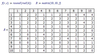

Example. Create a matrix with random numbers:

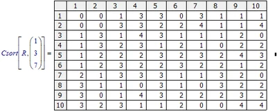

Sort it on columns 1, 3 and then 7:

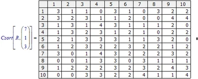

Or sort it on column7, then 1, then 3:

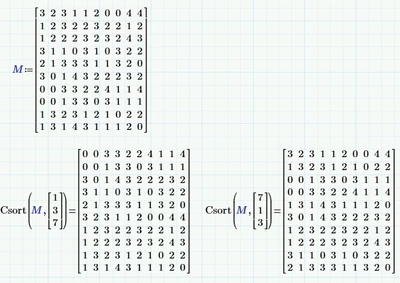

The same function in Prime (but with ORIGIN=0):
Prime 4 file attached.

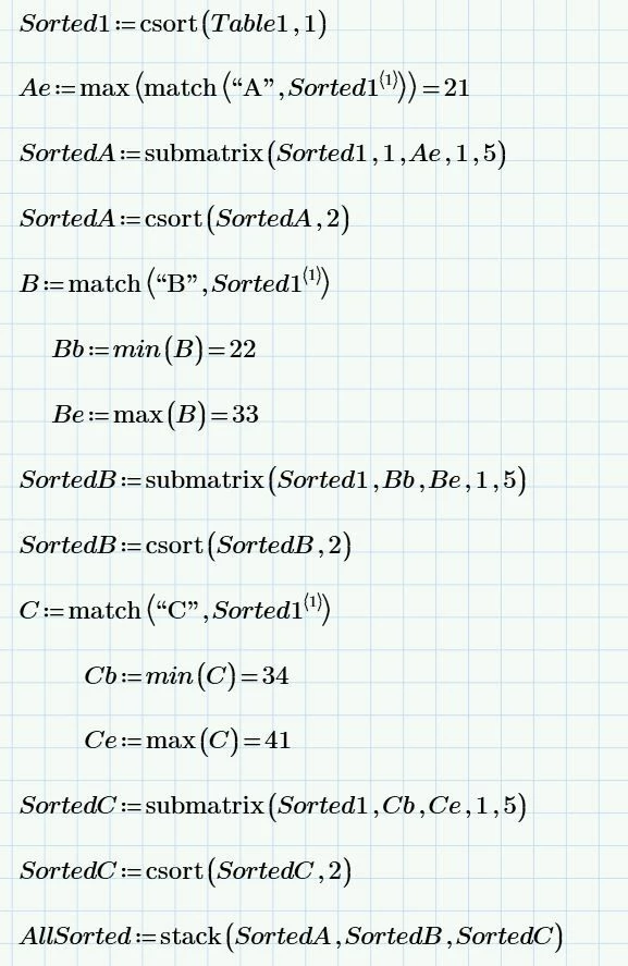

Can be done with following steps.
