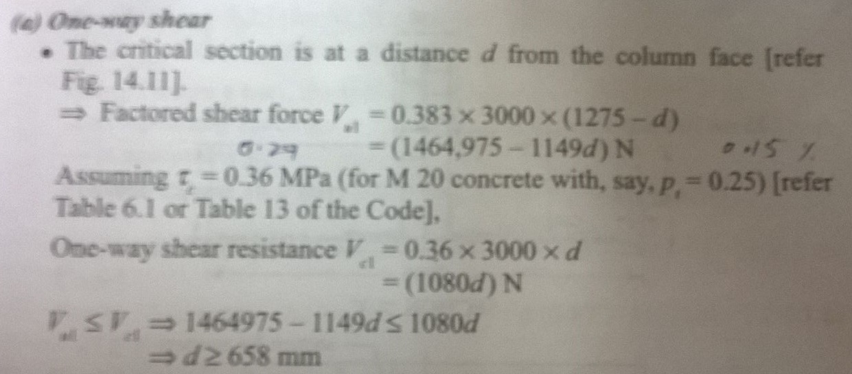

Hai please answer this question
If
  Vu=0.383*3000*(1275-d)
  Vc=0.36*3000*d
Vu ≤ Vc
Then value of  "d" ll be greater than equal to what ?AokPi_R8vrsjvPwvgbAPxy0Y0JbJX_-vZaKW3jcXsNSn.jpg
Werner_EAnswer
You may user the symbolic "solve" to do the job:
And if you don't mind the red errors thrown by the numerics, you can define Vu und Vc as variables and not as functions in d, if you prefer it that way
