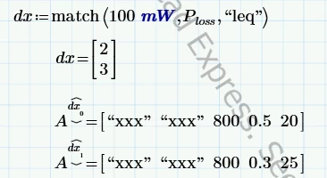

The command you're looking for is "match".
match will return the indices of all of the rows that satisfy the qualifier (in this case "less than or equal to".)  My Prime 6.0 Express will not help you with 3.0.

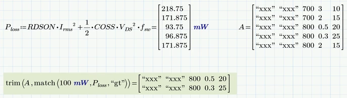

Would this help?
The "match" command finds the indices of all values in P.loss which do NOT meet the given condition (which are greater than 100 mW) and then "trim" deletes the corresponding rows in matrix A.
