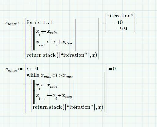

I want to make a vector calculation problem, and i want make a graph for representation for solve my problem
For this, i need to hash a range on axis
Example:
For x axis
I define xmin:-10mm
I define xmax:10mm
I define xstep:0.5mm
I want to make a program for define a matrix that include all value.

I try it ...
with "for"
but i can't do it with "while"
September 27, 2018
May be so
XDN14-AlexandriteAuthor
September 27, 2018
Y try it with "for"
It's OK , but is not elegant ...

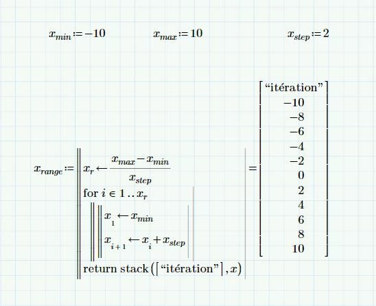

September 28, 2018
Hoe about this:
File in Prime 5 format attached
October 1, 2018
Thank's It's great

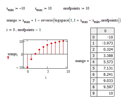

Now, i want to reduce step when approaching the end point.
I use a new parameter for reduce step, or , i use a function (for example sin)
The end point is max positive value
October 1, 2018
Not sure what exactly you are looking for.
How about using "logspace"?
