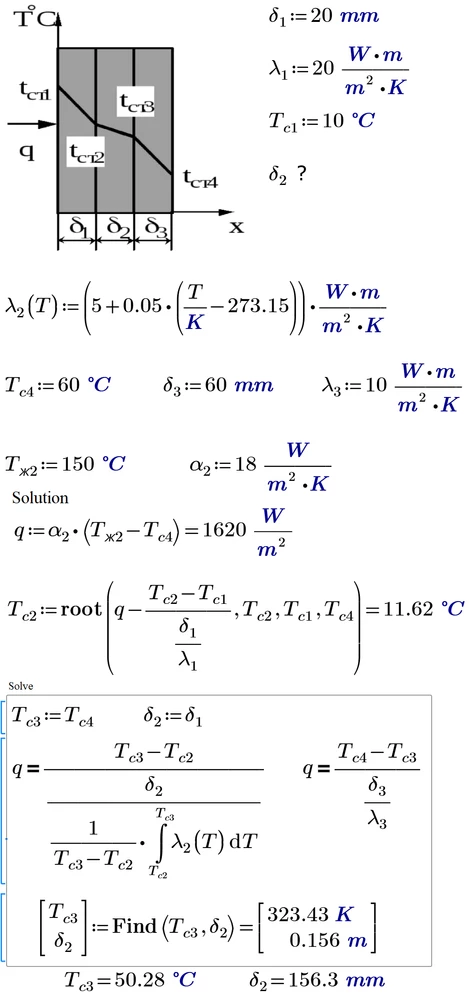

In the attachment and in the figure, the simplest problem from the problem book on heat and mass transfer, which I am currently working on.
Can you create more simple solution?

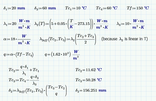

I would say that the following is simpler (it is even done in Prime Express)!
