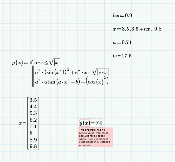

Hello, i have problem, can someone help me with PTC Mathcad Prime 11.0.0.0?

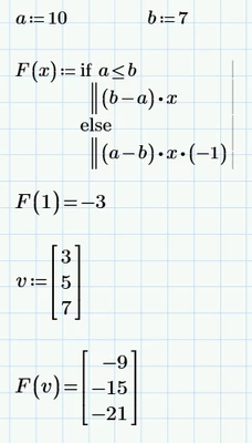

Aug 18, 2025 6:12 AM UTC
you have to define else branch for if command. See below.
Next time ... please upload your mcdx file.

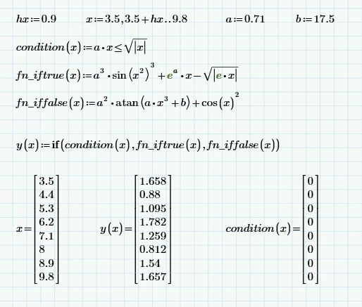

Aug 25, 2025 9:19 AM UTC
Here's an alternative approach (notice that, for the x-values you use, the condition is always false):
