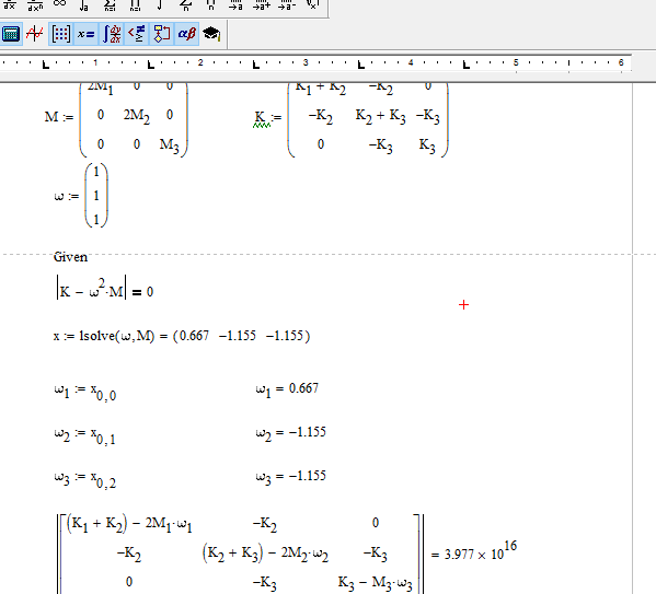

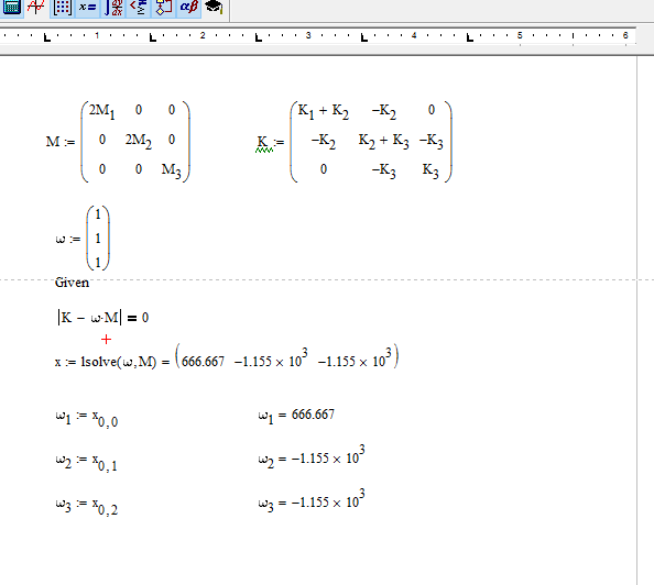

I have an assignment where I have to determine the three cicrular frequencies and periods of a free vibration (EQ. resistant engineering).
the way I am trying to do this is using the lateral stiffness and mass matrices, [K] and [M]. In order to find the frequencies mentioned above I used the following equation:
det [K - omega^2*M] = 0. My question is, how can I solve this equation using Mathcad? the mass and stiffness matrices are the size of 3x3. I am looking to find the three omega^2 values.MathcadProblem.PNG
this is what I have so far, but I am sure it is not right, because no omega should be negative.

Your determinant should have omega squared
adawson-21-VisitorAuthor
April 11, 2016
the determinant having omega squared soes not change a thing

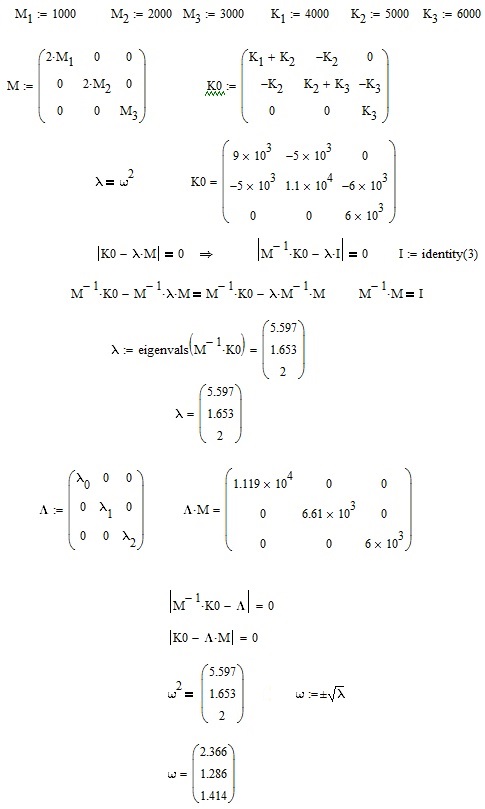

April 13, 2016
I think that the answer you seek is the following:
