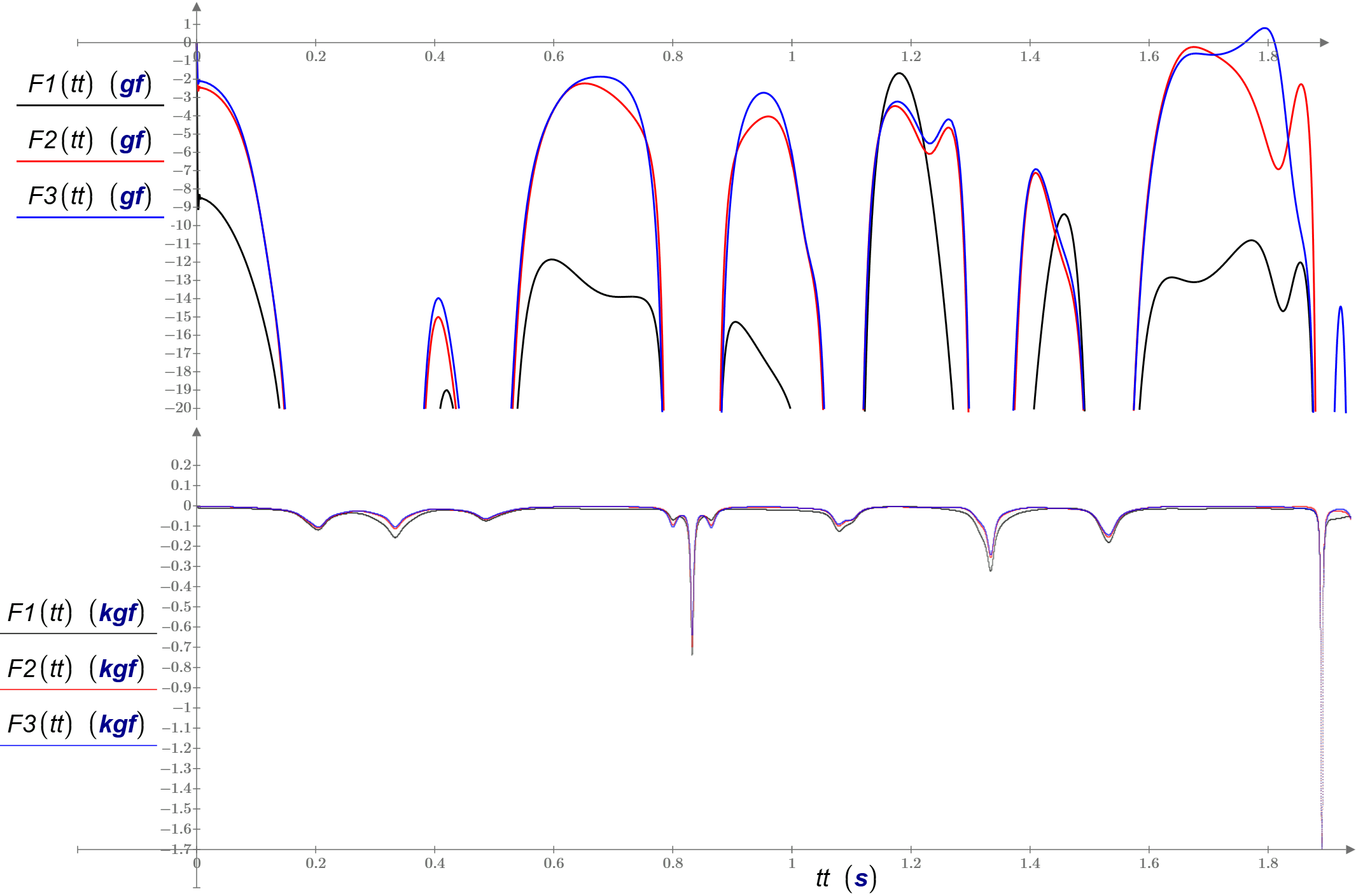

But is the model correct?
Must forces F1, F2 and F3 be always negative?
See please re attach!

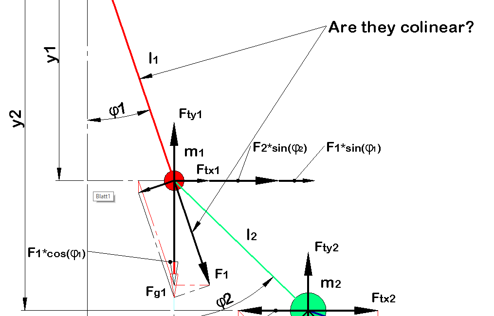

Valery,
What are the Forces F1, F2, F3 exactly?
Are these the Forces which have the same direction like the strings (=colinear)?
I try to verify the acting forces again  to be sure if all be allright.
Yes!
F<0 - Stretching of the string

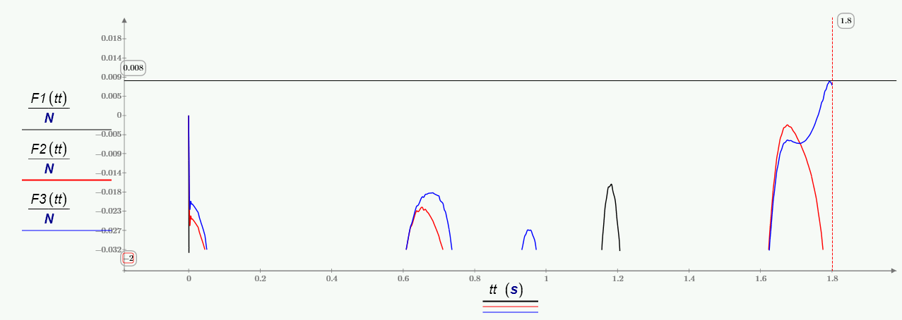

F>0 - Compression - not possible with a string (see at t= 1.8 s). Check please!
>F>0 - Compression - not possible with a string (see at t= 1.8 s). Check please!<
With an ammount of 0.008 Newton- it's a inaccuracy of calculation in my opinion.
In that moment, we would have a free falling body.
We should do an experiment, and see what the string does make at the force>0. (needing a high speed camera)
If the strings are stiff (we didn't take into account at the beginning of our simulation) what would then happen?

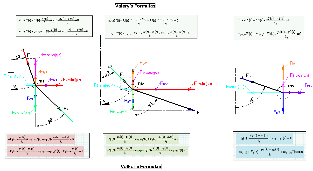

Valery,
I need help for better understanding according to your summation of Forces of pendulum-3-hard-linking.mcdx.
I created a dynamic balance, which you can see in the sketch.
The direction of force of the slowness is allways in the opposite direction of the acceleration vektor (D' Lambert's Law)
I confirm with your equations in x-direction, but in y-direction we have different equations.
The body mass m1 moves to the left in direction of the negative x-achses and it moves downwards in direction to the negative y-achses.
So the body mass m1 accelerates (increasing speed) downwards and to the left.
I am confused if i compare my equations with yours.
How did you get it, can you show me with a short sketch?
Can you please tell me what is fact here?
Thank you!
Volker
Sorry, Volker!

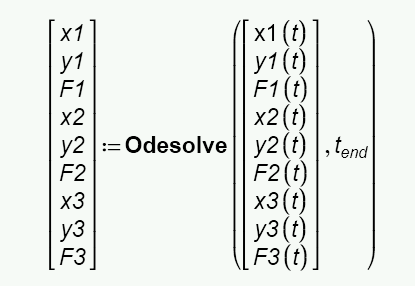

I input equations and see an animation.
If the animation is fine - equations are correct.
If the animation is not fine - I change equations and see new animation!
And I think about physic of course. But in second line
Main is a fine animation!
We have animation in Mathcad 15 but cannot work with units in Odesolve.
We can work with units in Odesolve in Prime, but Prime have not animation!
