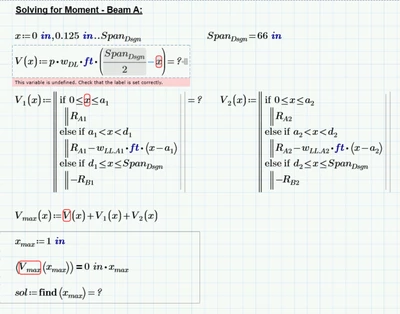

Can someone help with this?  I don't understand why the 'x' variable is undefined.  Any help would be greatly appreciated

I think your issue is the evaluation equal sign at the end of the function definition,
Get rid of that and see if it helps.
(BTW, what are the definitions of p and wDL?
Can you post the sheet?
