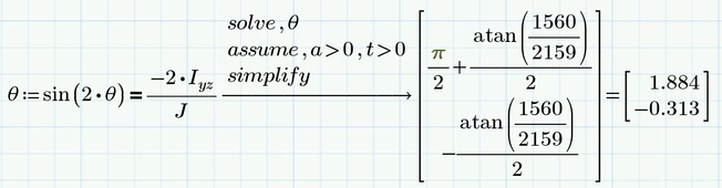

@kenan2 wrote:
Okay is it possible to find a solution in the interval [pi ; 2*pi] ?
If you tell Prime via an "assume" statement it should deliver what you demand. In case of your (unsimplified) expression Prime/muPad has difficulties finding a solution so we can help a little by splitting the task into two parts:
You may experiment by adding "simplify" and/or "rewrite,asin" at the end of the second symbolic eval to see the very same result written in different ways.
BTW, this is another example where the new symbolic in Prime 6 fails to find a solution.
6 replies
December 27, 2019
Keep in mind that sqrt(x^2)=x is only valid if we can assume that x>0.
So in your result a and t cancel only if we assume that both are real and >0.

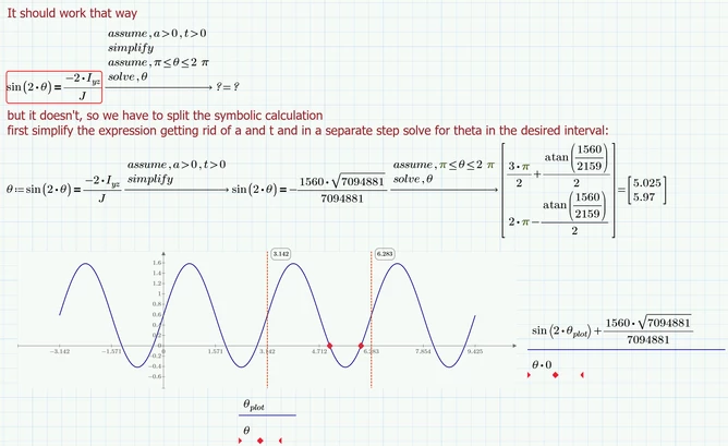

Werner_E25-Diamond IAnswer
December 27, 2019
