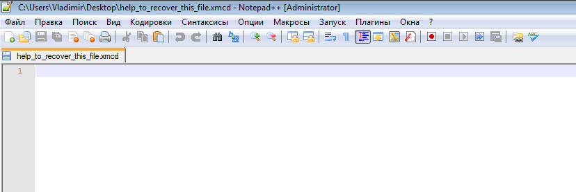

Your worksheet is completely empty, it contains nothing:

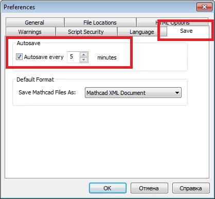

Autosave option for worksheets can be found in main program menu select: "Tools" --> "Preferences" --> "Save" --> "Autosave":

Thank you Vladimir, I found that there is no autosave setup in my account.  I did save it from time to time, and the size at the last successful save should be 2 to 3 MB.

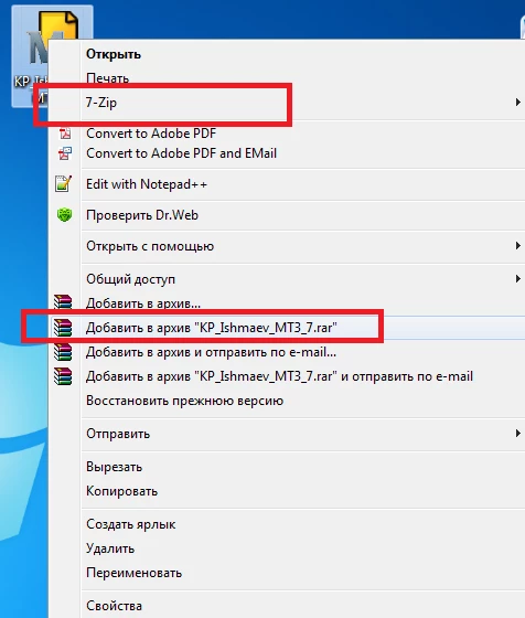

I think that other ways for restoration aren't present (except for a new manual set of the worksheet). I can also recommend on the future after each closing of the document to make its archival copy by using some of archiver program like WinRAR, WinZip, 7-Zip (you simply click the right mouse button on the file and it can archive copy).
