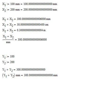

Help: Adding unit (mm) to a variable increase value by 0.00000000000003, why?
Hi there.
I just noticed that when add 2 variables defined as length (mm), the resut increase the value of 0.00000000000006.
Can someone help me figure out why?
As you can see from the picture below, adding the unit after the addition removes the error.
Result Format
Format: General
Number of decimal places: 17
Show trailing zeroes: yes
Format units: yes
Simplify units when possible: yes

Thank you for the reply Adrien,
But wouldn't that only be a problem with complex numbers with number below 10^-17 (which seems to be mathcads limit)?
In this case I ask the program to do 100+200, which should result in 300. I give no additional inputs of any value, only unit.
How I read it, it seems that at some point mathcad evaluate the defining of units as a number. And as far as I can tell, it's only for (mm)
Could this perhaps be a bug, or just in my settings?
Note: This is not for anything as fancy as a GPS or rocket science.
I'm currently creating a simple automatic tolerance check. The problem is that later on I use a program to determine if a value is too low or high depending on given criteria.
Now in this scenario if I had the maximum allowed tolerance as 300mm, the output would be Fail due to too high dimension.
Setting Zero threshold does not help eiter since mathcad stores the full value of the variable, and are therefore, above the accepted value.
+It really enoys me that I don't understand where the extra 6*10^-15 comes from.

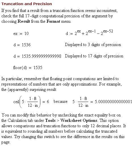

It's numeric roundoff. This is inherent to numerical computing. A 64 bit float only has about 15-16 digits of precision, and any comparison has to take this into account. That's why you should turn off exact equality checking in the worksheet options.
Why do you only see it with certain units? Because Mathcad converts any quantity to the base unit (in this case meters) and stores that. Like every numerical operation, that conversion results in roundoff error.

Have a look at the help for the Truncation and Rounding functions ...
Note that this limitation applies to any software that uses a fixed-width binary number internal representation of floating point numbers; it's not Mathcad specific.
If you need more precision, then try using the symbolic processor (although, you must bear in mind that it's not unit-aware; unlike the numerica processor, which is specifically designed to handle units).

Thank you Stuart,
This helped alot for my spesific case. Using round(z,n) with n=3, for 3 decimal places worked like a charm.
I am still confused about why and how the problem occured in the first place.
But for now I am content.
