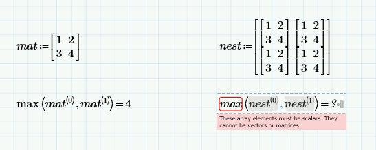

And according to the ”Help function” you can use Arrays??????
Yes, and thats true.
But what the help does not tell you is, that you have to use arrays of scalars.
In other words - the arrays must have elements which can be compared by size and they even can be complex numbers (which can't be compared by size from a mathematical point of view) as described in the help.
You don't show it but the elements of your matrix where you provide the columns of seem to be not scalars. Maybe the are matrices themselves or something else.
You would have to provide mor information about your matrix and about what maximum you are looking for.

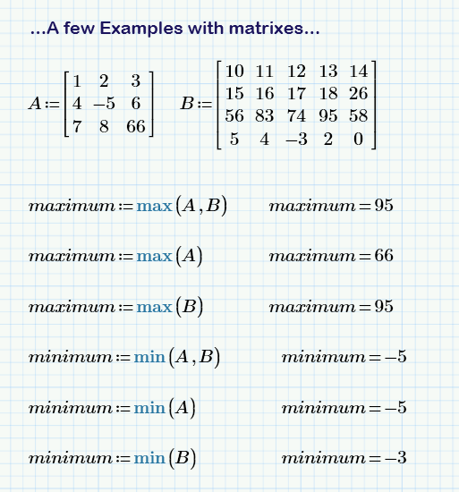

November 20, 2016
Gerd,
maybe it helps you...
Volker
