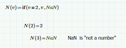

In mathcad prime 3.1 , how can i make the evaluation equal to ( no value ) ,,, for example if the condition is satisfy all the next parameter does not work
I need any help about this or how can i make that with another way
thank you

Something like this?
