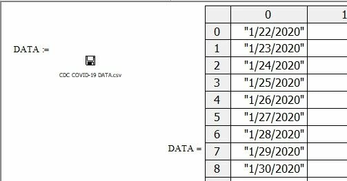

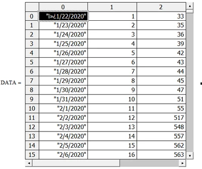

When reading the two csv files into the Mathcad file, the first element of the DATA file is corrupted and looks like

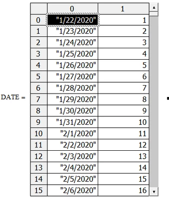

However, the DATE.csv file reads in correctly as:
What is causing the corrupted first element when reading in the DATA.csv file.

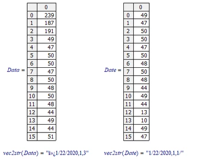

Your problem occurs because there is actually some data in front of the first date, in the DATA file.
I read the first 16 bytes of each file to show:
Note that 49 is the ASCII character "1", that's where the date starts.
Whatever you used to generate those .CSV files, has put those extra bytes with values 239, 187 and 191 in front of the first date.

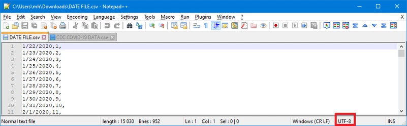

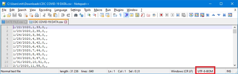

I opened both csv files in Notepad++.
DATE FILE.csv ... file format is UTF-8
CDC COVID-19 DATA.csv ... file format is UTF-8-BOM ... this explains 3 "invisible" characters at the beginning of the file
CDC COVID-19 DATA.csv ... file size = 31 239 bytes
SOLUTION
In Notepad++
  • create new file
  • select the entire contents of the file CDC COVID-19 DATA.csv using CTRL+A
  • copy selection into clipboard using CTRL+C
  • copy clipboard contents into new file using CTRL+V
  • save new file as new CDC COVID-19 DATA.csv
  • new CDC COVID-19 DATA.csv ... file format = UTF-8 ... files size = 31 236 bytes (3 "invisible" characters were removed)
