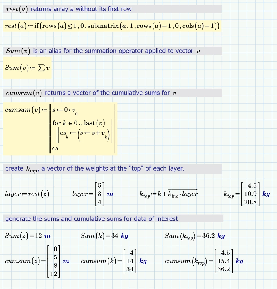

Possibly something like this?

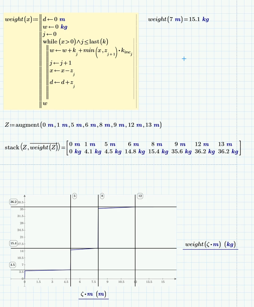

Or, if you want to change the profile from linear,
There are many other ways of skinning this particular cat.  This was simply the first one that occurred to me.  Hopefully, others will be along to present better methods ... some so obvious in retrospect that I will spend a good few fruitful hours kicking myself!
Stuart

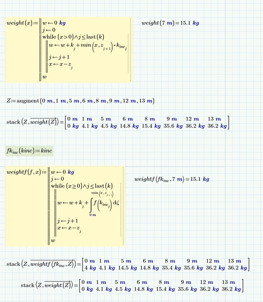

I've no idea why I left those "d"s in the functions.  I meant to delete them.
Here's the d-deleted form for the functions.

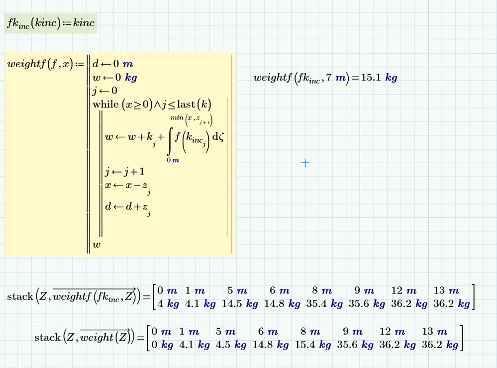

And a couple of functions that helped me check the results of the weight functions.
Stuart

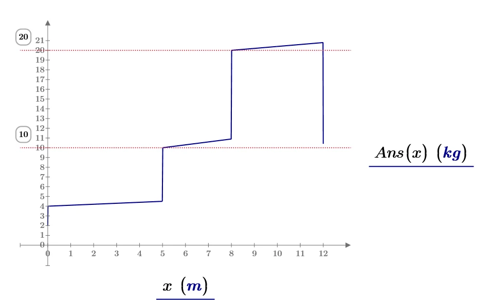

I made an attempt myself, but failed. I want it in a more simpler manner.
What is wrong whit this code?
ttokoro
z include z[1, z[2, z[3. Therefore, you shoud use different valiable name such as z1, z2, z3.
If you want use z[1, z[2, z[3 for only one variable z with many rows, compared value name must change such as x to compare each z rows.  So I made Ans(x) function not Ans(z).
