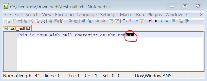

the error message tells you that your license file contains unwanted invisible character(s) ... hexadecimal null character. See attached example.
Suggestion: Install Notepad++ editor, open file, remove NUL character, save.
