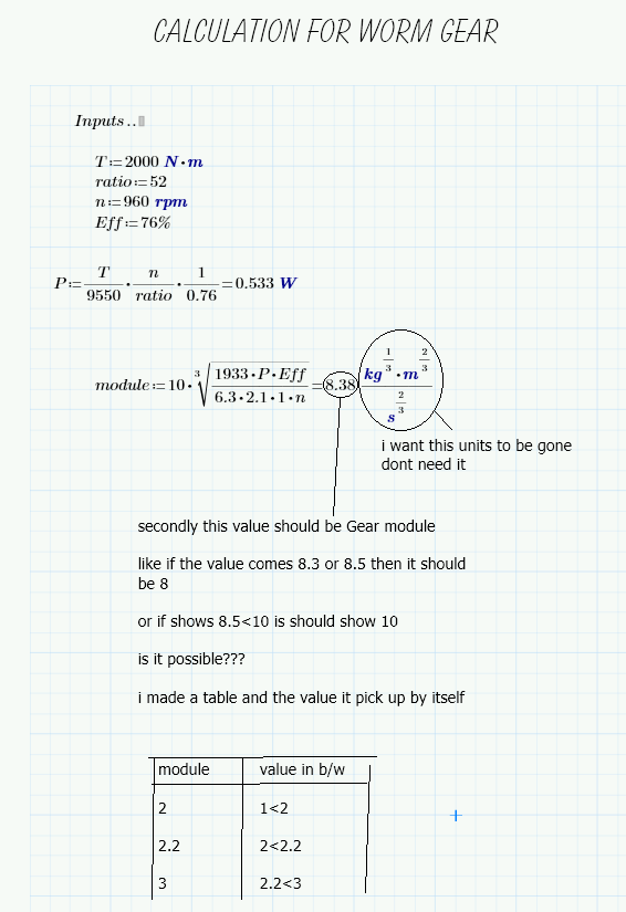

Please, attach your worksheet.
Nov 18, 2011 7:56 AM UTC
here it is
Nov 18, 2011 8:45 AM UTC

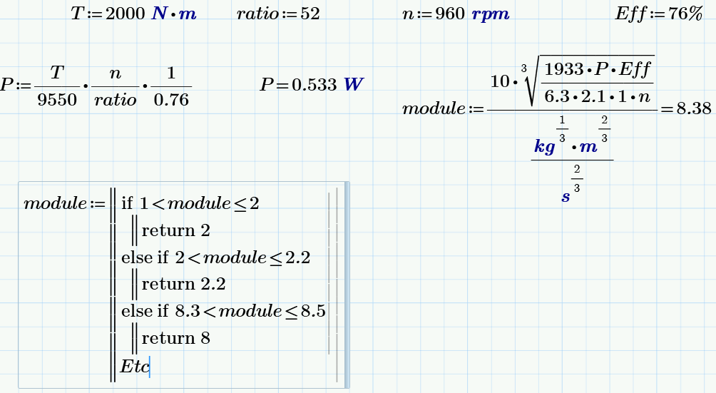

May be so:
Nov 18, 2011 9:40 AM UTC
Thanx Valery Ochkov
but i dont want it to be show in printouts...
Nov 18, 2011 11:03 AM UTC
Show what?

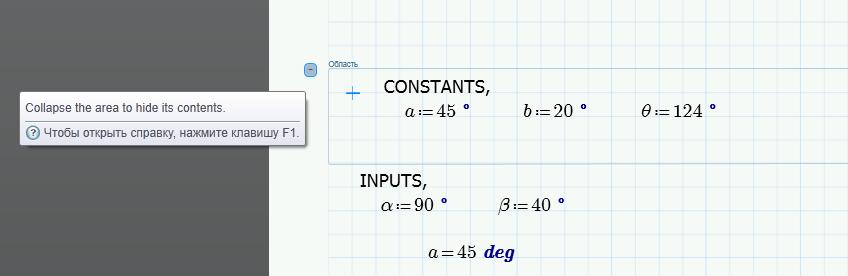

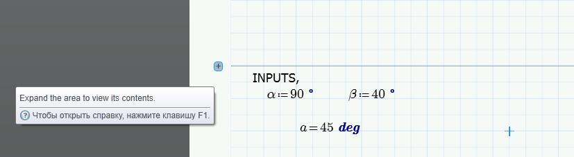

The ability to create collapsed areas will be available in version Mathcad Prime 2.0.

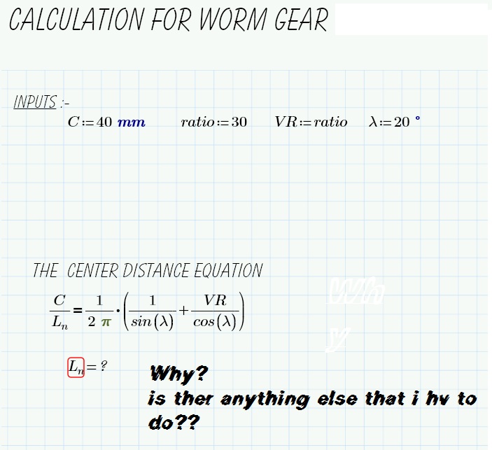

Nov 29, 2011 3:22 PM UTC
couldn't find the Ln....
Nov 29, 2011 3:48 PM UTC
See the attach.
Nov 29, 2011 4:00 PM UTC
thanx but i was expecting somthing else. the solutoin u gave i'm already using it. i thought that Mathcad can drive equ. by itself.
