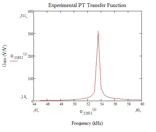

I have collected data points for a system that can be modeled by a third order transfer function (G= 1/(ax^3+ bx^2+cx^1+d)), at resonance. I would like to try and curve fit the data so I can analyze the experimental with the model but I cant figure out how to do it. I have tried the pwrfit and genfit commands but without luck. The plot of experimental data is included.

Please attach to the message (by using "Use advanced editor") your Mathcad worksheet.
Jan 21, 2012 10:47 PM UTC
This is easy to do. Genfit is one approach, but minerr is a better one. Please post a worksheet with the data and the equation for the model and I (or someone else if they beat me to it) will show you how to do it.

I have attached the data set and form of the equation.
Jan 22, 2012 6:31 AM UTC
Anthony,
See in attach
aroberts1-VisitorAuthor
Jan 23, 2012 4:57 AM UTC
Thank you, this helps immensely. How did you come up with your initial guesses though (vg)?
