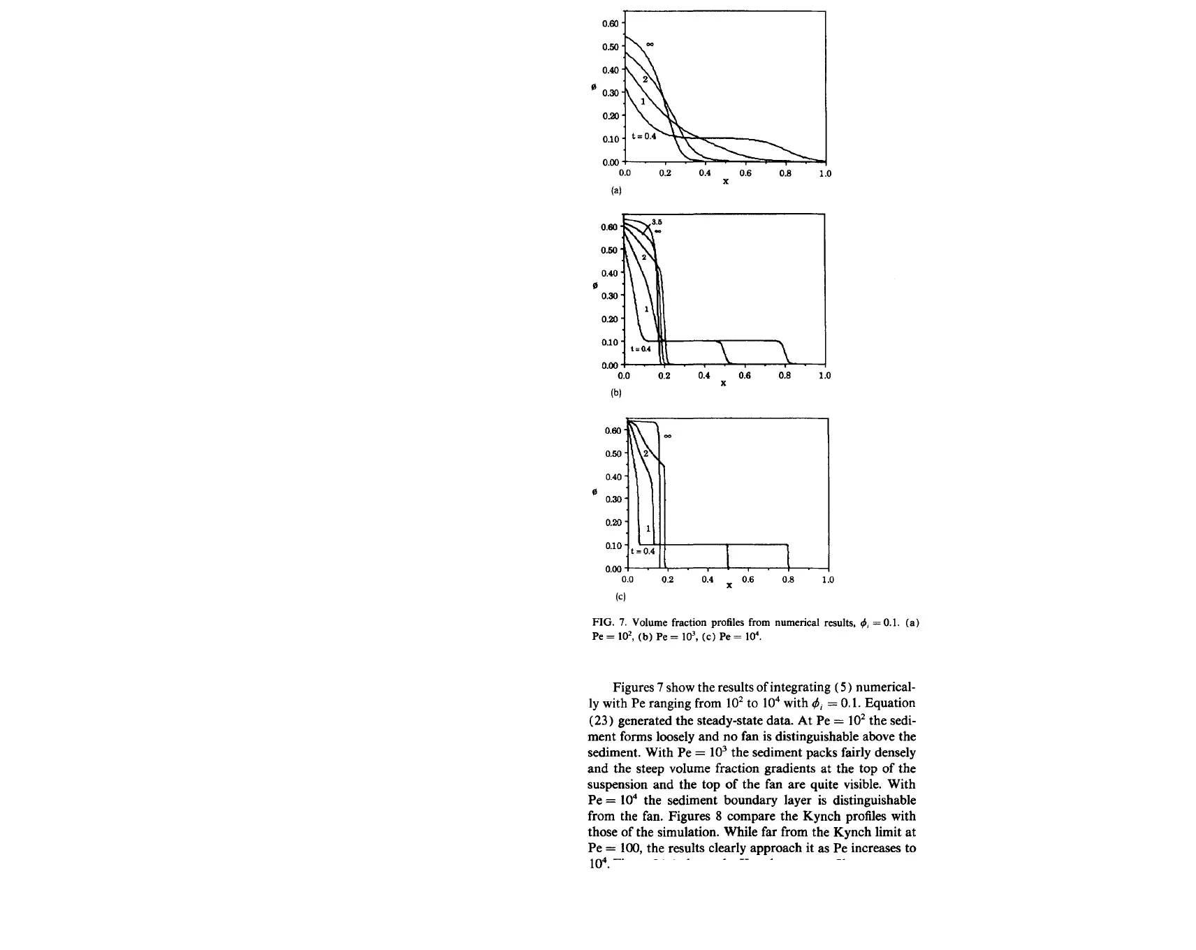

     I need to solve this equation to get an expression for volume fraction, phi (x). For the given constants, phi (x) vs x should look similar to that in figure. Kindly check attachment. I tried to solve it symbolically but it keeps showing an error.

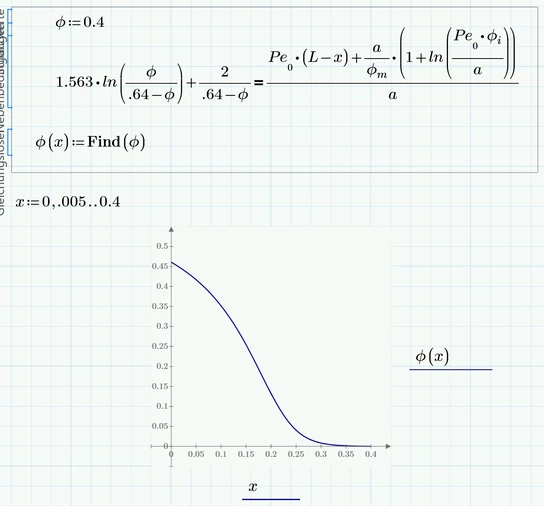

.) Don't use and define a range for the independent variable x in front of the calculation- Just use it for plotting.
.) You can't solve for a function, so use just Phi and not Phi(x)
.) There is no closed analytic solution to your equation. That means that the symbolic solver is useless here. Just use the numeric solver and turn the solve block into a function of x as shown below:

Thanks a lot Werner. I have one more question. This solution is at steady state (t= infinity). To understand phi (x,t) vs x for different time t, one needs to integrate the expression (please check pg 2 of mathcad file). Could you please tell me how to go about doing it?
Regards
Obviously a partial DE. But you are using Phi as variable as well as as function of x and t. You should clear this situation before you go on.
